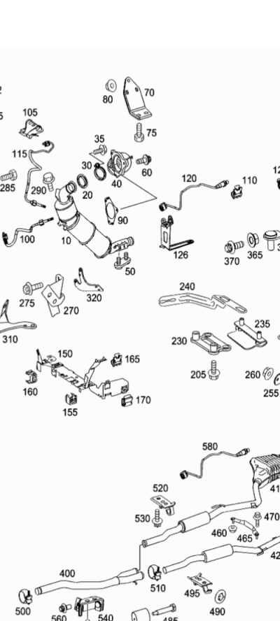

Late 2008 model, S320 CDI After the engine light came on a few times, I dosed the CAT twice with a spray can cleaner. The light comes on and off randomely now ie. I drove to Minehead, 160mls and the light came on halfway there. We drove around for a week with it on , then, on the day we returned the light was out and didn't come on for the rest of the trip. Since then it comes and goes as it pleases! There is only one sensor which is in the main body of the CAT and that is the only one on the whole exhaust system. I assumed it was an O2 sensor but others have thrown up doubts at that. Any ideas please. also ,how to test if it's faulty. I've had in on my iCar soft which just says CAT clogged, but it 'ain't.
