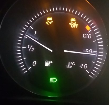

Its taking approx 20 minutes plus for the engine to get to operating temp, in some instances I've noticed the temp drop instead of increasing
Is this normal? Or would this point to needing a new themostat?
Yes, looks like a new thermostat is due.
Assuming your car has the M271 engine, then you're in luck on the thermostat front (though not so much on the timing chain... but that's a different story). The thermostat on the M271 isn't expensive and easily accessible.
Apologies can the admin amend the subject title its a w204 not w205, cheers
After 20 mins of driving this is where the engine temp needle is sitting

Car has only done 50k i was thinking the weather maybe a factor but 20 mins to get to temp does seem excessive

Just did a test with the heater controls off, car started from cold and idling, not driven at all, it has taken 17 minutes to reach 80 degrees
As soon as i put the heaters max speed and max temp on the temp needle starts to drop
Would this still indicate that the thermostat is faulty? or is this normal?
Yes it does, not normal. You need a new thermostat.
