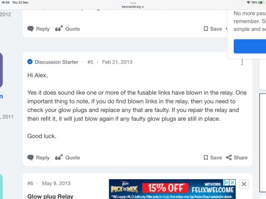

You have to be careful with that , it’s not unknown for an old glow plug to fail and damage the new (£100+) relay .
Surely if any of the plugs were at fault a continuity test would show up the fault or the glow plug light would be lighting up, or are you saying change both the glow plugs and the relay.
Yes that’s how I understand it to change the plugs and relay at the same time , at least that’s what I did .
If after changing plugs and relay I got a gp fail a year later , I would then just change the single plug.
I think in this case we don’t know how old all the glow plugs are and they are a consumable item .

Ok fair enough, I just changed the relay cos my glow plugs weren't that old and I wasn't aware that glow plug failure would fry the relay.
