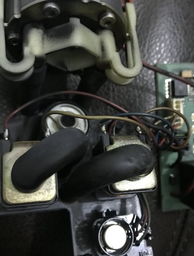

Thanks all. Will try silicone approach to unlocking boot. The battery died after I reconnected the dynamic seat pump fuse.

Oh My God. Just opened the dynamic seat pump horrible burning smell from it. Looks a right state too
The ground on the pumps soldering was no longer there and a lot of black soot. Whole room just stinks of it now.
