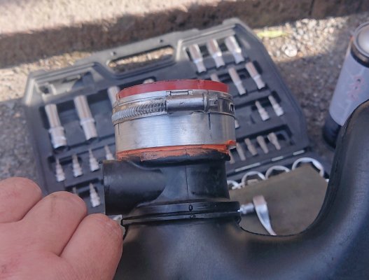

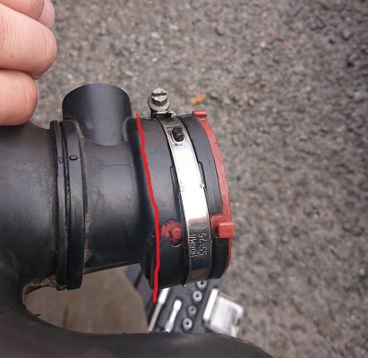

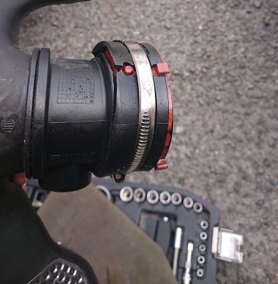

So as we know the intake on W211 likes to crack. Buying new from dealer cost fortune and china replacement not always are the best and can crack as well. I had my second one fitted and this has cracked as well. Didn't want to buy from dealer or China so i got it modified. I had problem with the flaps actuator so it was time to solve both problems. You have to remove the intake, cut it around 2mm from the side pipe and insert the modified part. You can use silicone on the join just to be sure but anyway it should not leak anymore. From the orange seal you have to cut all the nibbles . I know it can be done nicer :eek::D but I'm not mechanic and was doing it bit in rush :) Its quick and easy job.
