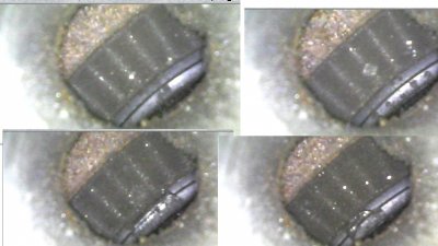

Removed the speed sensor and used boroscope to take a few snaps and the "ring"
Trouble is, I don't know what a good one looks like, there appears to be damage.
Thoughts?

But is it the speed sensor or the reluctor ring?
After consulting Mr Google I thought it was the sensor as it was open circuit. But digging deeper there are passive and active sensors.
The active type, which I may have, do present as open circuit, so you can't use that to determine failure.
