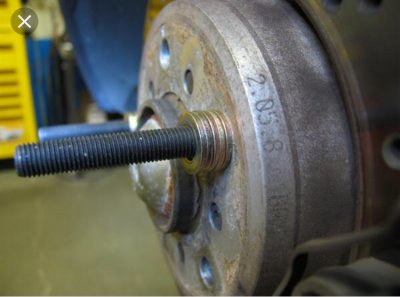

Hi DSM,
Sorry I didn’t see your post yesterday. Thanks for replying.
I have thought about the wheel not sitting on the hub lip when using the washers. I guess this will only be a consideration if the amount of washers used exceeds the depth of the hub lip so the wheel has nothing to locate on to.
If the washers did exceed the hub lip I guess you would be in the same position as if you were running non hubcentric spacers.
Whichever way, for the purposes of what I’m trying to achieve which is just to measure accurately what size spacers to order, I don’t think it will be an issue/concern.
The car is not intended to be driven at all while the studs and washers are attached. Now that would be dangerous!
It’s basically something like this I’m looking to do, just with more studs..
