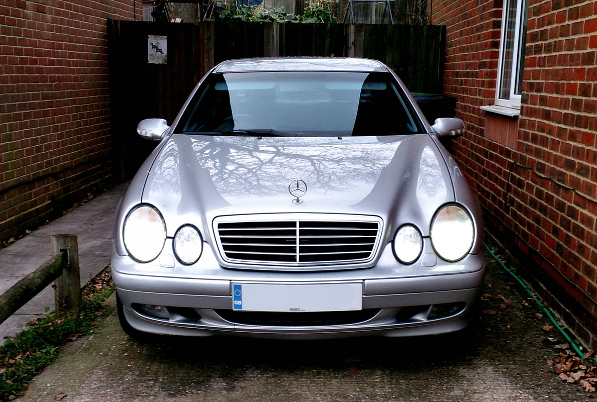

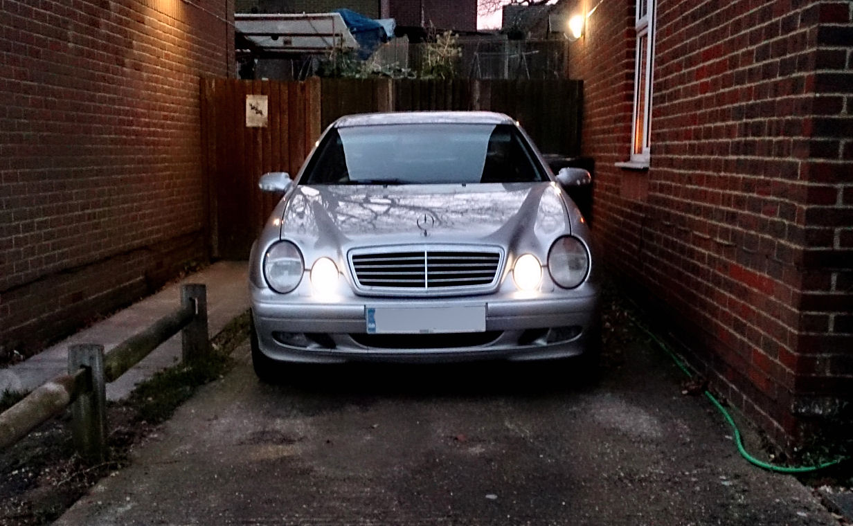

I replaced both mine when I got the car, an old CLK320, with new ones because I noticed they were different shades.
I fitted these: (D2R 6000k £6 odd a Pair) 2pcs 35W/55W Car HID Xenon Headlight Bulbs D1S/D1C D3S/D3C D4S D4R D2R D2S D1R | eBay
They seem to be fine with a distinct cutoff.
But I also fitted these for the Sidelights as I hate that "Yellow" look compared to the Xenon Headlights - they seem to match OK.....
2x BAX9S H6W Sidelights LED set kit error free canbus Bulb 10SMD For BMW F30 F20 | eBay
Not bad at all......
Total cost - less than a tenner!
