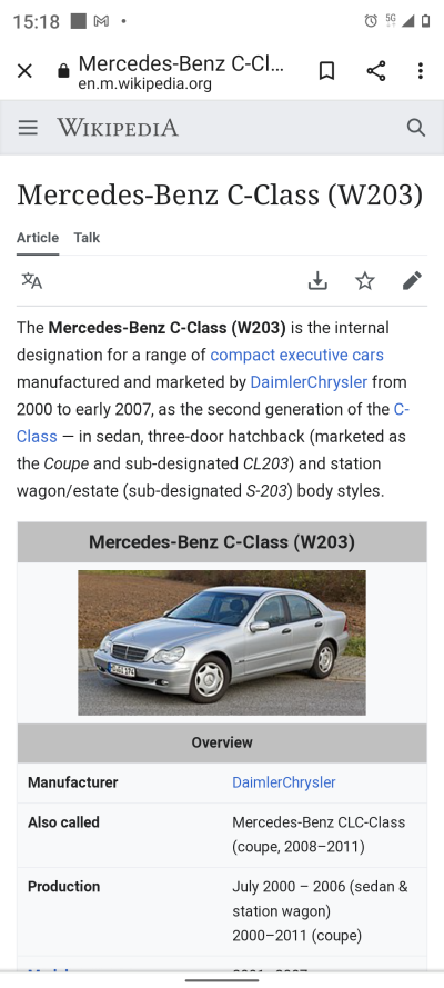

Regarding of "CL" i didn't use it 😉. It's cl203 sub model of w203 in coupé body style. It's needed to be mention when ordering certain parts and just got used to.
