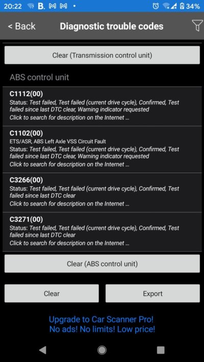

I scanned the car before buying it and it had a code for Front Left wheel speed implausible data.
I've got the car home now, and after bit of driving around, it became undriveable, it was locking up the rear brakes under any acceleration.
Now when I scan it, it has codes for both front wheel speeds.
I unplugged one of the sensors, cleared the codes, and then car drove fine, but obviously still had lots of codes.
I then swapped both front sensors from left to right and vice versa. The sensors are genuine MB and appear to be in good clean condition, with no damage to the wiring or connector.
If I clear the codes and start the car, all the warning lights remain off, until I drive the car. As soon as I drive it, I get codes for both front wheel speeds and the car puts the rear brakes on.
If I clear the codes, start the car, and disable ESP using the car's menu, the warning lights come on, but the car drives just fine.
When observing the wheel speed values using a scan tool, the two fronts are showing 0.
Is there anything else I should do, or would you agree that it has damaged/contaminated ABS rings, and I should probably just order 2x wheel bearing kits which comes with the ABS ring. Or am I completely wrong and something more serious could be at fault? Any thoughts welcome. I'd rather diagnose it properly rather than fire the parts cannon, since it all appears to be nice and original.
Attached are the codes, cheers,,
That is pretty much a symptom of failed reluctor rings or, some other cause for the wheels to be read at wrong speed (eg, wheel/tyre diameter discrepancy). Lights at key-on without motion point to circuit or component failure, waiting for the wheels to turn points to implausible data.

Success! Fitted two new aftermarket ABS sensors on the drive and the car is fixed! £20 fix!!
