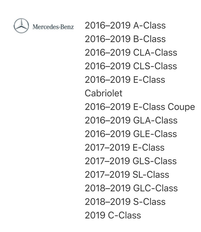

According to Apple's website, Apple CarPlay is natively supported on the GLC from 2018 onwards, so I guess the answer is No:
Said that, you can always give www.comandonline.co.uk a call, they know what's what.
If it does indeed turn out that Apple CarPlay cannot be activated on your car, you can consider opting for 3rd-party hardware solutions that will add Apple CarPlay.
