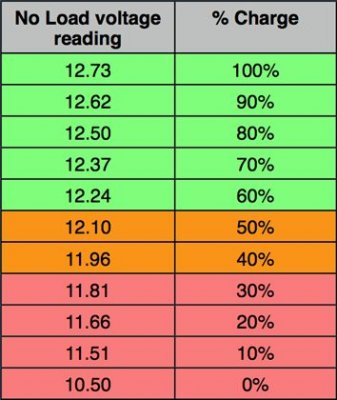

11.5V isn't good , that's a flat battery !
