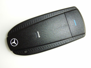

Hi. Im looking to add Bluetooth to my 2007 E280 elegance. I have this phone dock in the centre armrest. Does anyone know which part I need to buy to be able to connect my iPhone handsfree? Thanks.

This should do:
Seems to be out of stock at Comand Online, eBay should have them.
They only enable Bluetooth phone calls, not music streaming.
If you want music you will need to find an Aux input or swap the head unit out for a new android one
If you take the HU out you might find an Aux in socket to put a lead into as some did.
You could power an FM transmitter off the 12v but they can be hit and miss if you really do want to play music.
Some decent OEM like Android HUs are available for not silly money.....
The Viseoo does play through an iPod (remember them ) connected via a cable
