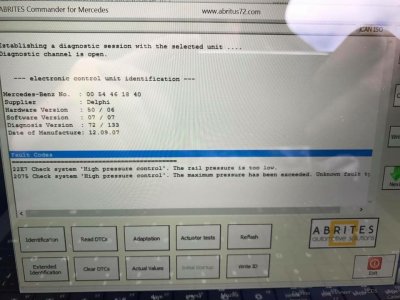

Diagnostics has 2 fault codes in the ecu
Fuel pressure exceeded
Fuel pressure too low
Strange to have both !

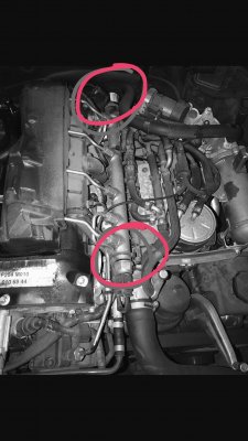

So after a bit of digging about me and a friend changed the fpr circled at the top of the rail.

Pics above show fault codes

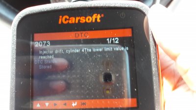

Im driving a 2008 Mercedes Benz C220 cdi w204 and when i accelerate the car goes to limp mode ..i have services all my injectors cause the fault said injector no4 has reach its limit but the car still goes in to limp mode ..can someone help me
