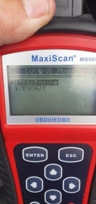

Can anyone help with this fault code

Cool thanks. I had it reset to see if it was just water from weather related
Your $7E8 and the $7E9 are fuel/ air intake codes.
