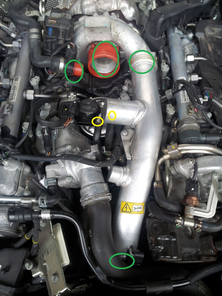

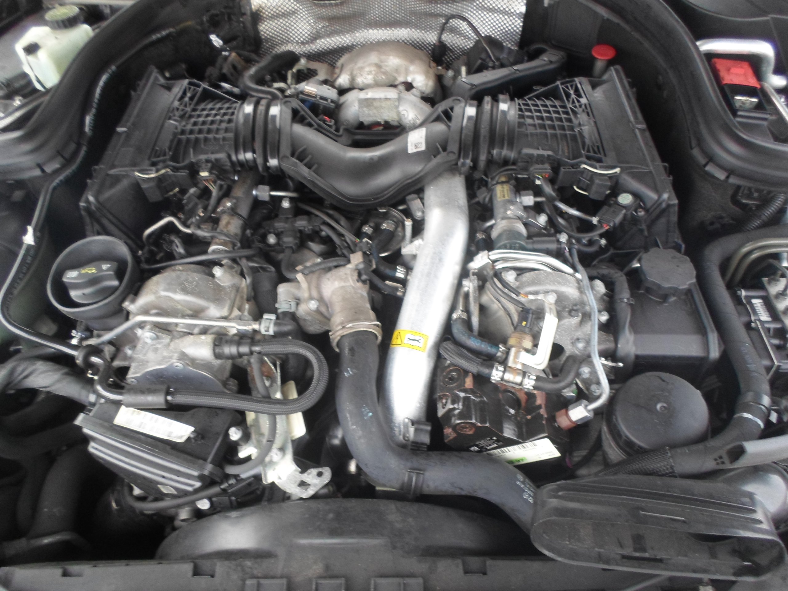

I cant think it would harm but I'm not a mechanic. If you're half competent with spanners Mick take the engine cover off and check left and right air filters for debris. Then remove the MAF housing which is the large black pipe part shown here
ae9f60e54280adda535cd369ad13
You should be left with this view
I would highly recommend replacing both those red seals as the large one is prone to leaks and that can cause issues. I'd also give the MAF sensors a spray with switch cleaner whilst you're there. You cant actually touch them so spray through the plastic mesh on to them.
