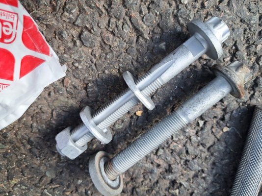

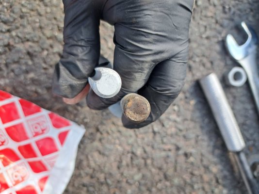

We only have these fixed bolts, they only offer a small fixed amount of correction either positive or negative depending on how the bolt is inserted. I took a photo of the lower arm to compare with standard bolt, should make sense by looking at the ends of the bolts. The washer plays crucial part, it shifts the bolt either inwards or outwards. 👍20230216_154104.jpg

The mounts at the base of the shock absorber fix differently onto the stub axle, it will not allow for eccentric bolt to revolve to give that movement. Its basically rigid once bolted down to the stub axle, photo stolen from ebay, should explain better than words 😁Screenshot_20230216_224819_eBay.jpg

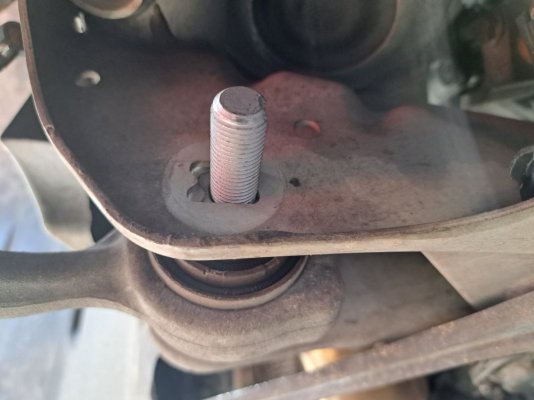

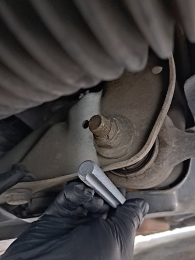

It's been over a year and a half, finally I had some time to install the camber bolts today. The nearside was quickest to do but the offside took a bit longer as I had the intercooler charge piping in the way. All done now, just need to do the wheel alignment again.
