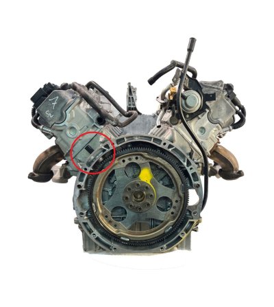

Depends on the engine but often the dipstick tube is pushed through a rubber grommet in the engine block and held in with one bolt on a bracket. Undoing this bolt will possibly allow you to wiggle the metal tube upwards exposing the dipstick which you can then (hopefully) get to with long nose pliers and push it up.
On this M113 V8 you can see (top right) the only bracket that holds the tube in , removing the bolt has the tube come loose , it wont come out on this particular engine but on yours it just might give you enough wiggle room.
Ignore the red circle on the photo , thats the CPS.
