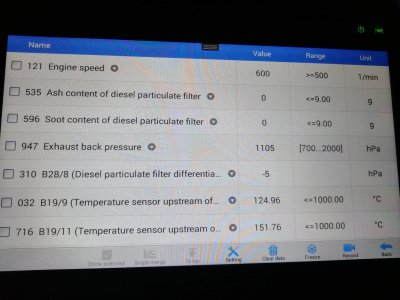

Hi all
I'm new here, having a small issue with my MB E350 3.0CDI 2009 C207 Coupe. Hope someone can point me in a right direction ?
Bought this E350 a few weeks ago, on the way back from the trader engine light came up. Did not want to bring it back to the seller as was 4hours away and we really wanted the car.
So far I've done :
Full service (oil + all filters)
Brake Discs/pads all around + tyres
Thermostat replacement (someone fitted incorrect one and car did not warm up beyond 75degrees). Now car warms up to 93degrees as it should.
As a result of the wrong thermostat fitted car would not perform DPF regeneration, thus DPF was nearly full and in a need of immediate regeneration.
Regeneration went through (saw the DPF temperatures over 600degrees on my Autel MK808 + ASH & SOOT values went from 9 to zero)
Car drives well, only goes into a limp mode after a few days of daily driving.
In the engine bay I noticed that on DPF pressure sensor B28/8 (original MB one 0281006025/A0071536128) there were undone hose clamps, someone probably investigated the DPF issue not realising there was a problem with the Thermostat as well.
To the main problem :
I still keep getting an error (Error pops up on the scanner after the car is restarted, orange light comes up after 3-4 starts of the car + limp mode):
Error via Autel : 129700 - Stored - The Diesel Particulate Filter Is Defective
Error via obd ELM327 + Torque Pro : P2002 Powertrain - Particlate Trap Efficiency Below Threshold - Bank 1
My suspicion is faulty DPF pressure sensor B28/8, probably got damaged due to blocked DPF for quite some time... On Autel the B28/8 is showing values from -5 to +15 hPa, not sure what healthy car should show but negative values don't seem right ?
DPF is showing clean and working, exhaust pressure seems slightly high for idle..
Any suggestion how to test the B28/8 sensor, or point me to what I should check next would be muchly appreciated.
P.S. Error pops up after the car is restarted. When I erase the fault code, and go for a ride, code doesn't come up until I restart the car again (restarting it immediately or a next day doesn't make a difference)
