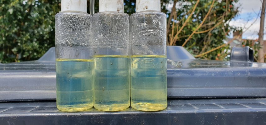

So finally had a warm day so I did a leak of test, all injector leak off flows are the same only difference i had was on no3 but its marginal so i think it's ok?

Better pic so no3 was slightly down on 1,2
