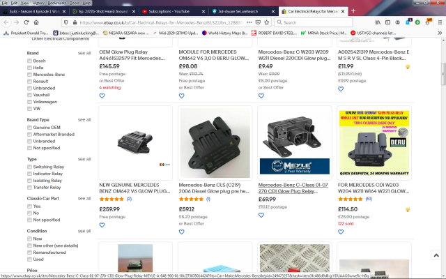

here is a picture of a vito version relay for glow plugs. Not the same but very similar. you should have something like this. However please consult a specalist for a precise diagnosis. Ask them how much, then walk away and think about it. Also double check your electric cables to and from the glow plug for wire chaffing1610174675196.png
One or possibly more glow plugs have blown and taken the relay with it. Its best to change all 4 along with the relay. Look for a beru controller.
