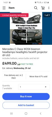

Hi, so i know this has probably been asked plenty of times before, just wondering if anybody has used this seller on ebay? Just bought myself a W204 C250 estate but now want to put the nicer looking headlights on.
Xenon (HIDs) do require washers to be legal and self levelling sensors. I would also imagine they require coding. However, the seller is stating they are plug and play which in simple terms means they will plug straight in but may not work fully. Does the description say anything else?

You can’t level these, they have a cornering light in the middle you can see on the stock photos. They won’t adjust electronically or self level
You can pick up a used pair of OEM facelift xenons units for under a thousand pound, so twice the price of those. Or you can buy new for a little more. You may as well find a donor car and take it all from there, including the loom, sensors, bumper, washers, suspension stuff etc etc
