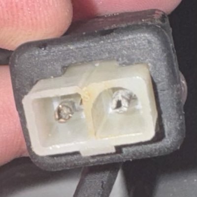

Does anyone know which car battery charger or conditioner uses this style of connector?
It looks similar to an SAE connector but the curved connector is at 90 degrees to what I might expect.
Looks like the ones on my Optimate motorbike battery tenders :
K
Thank you for your quick reply. I think it might be. Either that or an old style CTEK Connextor - after I posted I had a brainwave that it might be so I have emailed CTEK support.
CTEK make adaptors to connector older style chargers to newer style “comfort connect” accessories, but I can’t find one to go the other way, ie newer charger to older accessories.
The photo in the wikipedia article isn't a very good one, because it doesn't show the ridge that the clip on the mating plug latches over, but if you look on ebay for Tamiya connectors you'll see a lot of better photos. Coincidentally I've used a pair of these connectors to make a poor man's CTEK quick connect type of lead on my W221, for a Lidl battery charger.
Smashing, thank you 👍🏻
Just checked my Tamiya charger, definitely the male version of your female pic above.
Thank you for all of your replies, it’s much appreciated.
CTEK Support came back straight away and confirmed that it was a first generation “quick” connector, and recommended that it be replaced with a new generation CTEK Comfort connector. Now fitted, sorted 👍🏻
