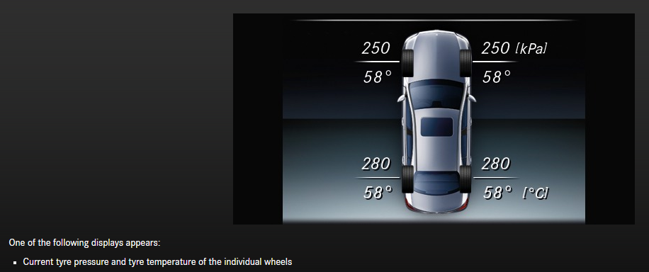

There are definitely temperature sensors in my (aftermarket) TPMS:

Based on what @knighterrant posted it seems to be an infrared sensor so probably in the wheel arches ... I was wondering what temperature it is - rubber surface or air .. From driving perspective I would THINK it surface temperature is more important - but then again, maybe not :)
Having now said that - based on what @GLK says it seems to measure air temps.

So Mercedes doesn't know lol - they says that the GT cars have the temp. sensor included in the pressure one but e63s - they don't know ... funny that - even looking through various online catalogs - there is no such thing as a tyre temp. sensor so who knows where the things gets it from.
I believe many TPMS sensors also include a temperature sensor within the valve body. It's all in the same unit. Even if the dash doesn't display tyre temp it is available via the OBD port. It may even be possible to recode the system with STAR to display on the dash, especially if it is available on other models. I doubt very much MB would spec and source different TMPS sensors for the different models

I bought after-market TPMS and there's a temp sensor inside the assembly. I would imagine that original MB TPMS does the same.
