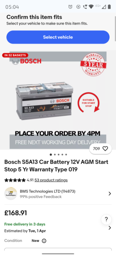

I checked carpart sites, battery size shows 353mm length for w202?
Just want to make sure not to buy the wrong size?
AGM avoids leaks from battery lead acid, seen very nasty battery trays on MB corroded by lead batteries therefore being curious about new battery technology like AGM.
Would AGM batteries have an advantage over lead acid when it comes to my cars factory power options?
Price difference is approx 50 quid between AGM vs lead acid battery.

I think that will be okay for your C43 and shouldn’t be too expensive 👍
