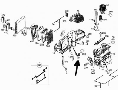

I have just bought a C220 and the aircon does not work. Everything checks out with refrigerant etc but when I have had the car diagnostics checked the system is flagging a fault that can't be cleared. It is an evaporator temperature sensor malfunction. The diagnostics say the sensor is recording -128 degrees. I have checked both footwells and removed trims to find a sensor to no avail.
Is the car fitted with an evaporator temperature sensor, if so where is it fitted? Or is the diagnostics flagging something that the car doesn't have fitted.

Think you may find its this:
Number 120 (Arrowed).
The part number is A2208300772
Replacement looks easy.

According to the EPC its the same part number A2208300772
Its also the same replacement procedure, the panel/s you need to remove are under the steering wheel.
