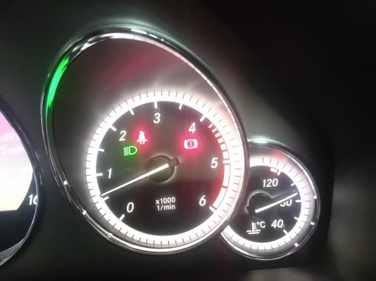

Yes it often goes to 70C and fluctuates but mostly sits around 85C, only under certain circumstances will it change. Since my driving is pretty consistent I can usually predict where this would be based on my driving style. And can prevent it if I drive differently.

Most of my cars have always just shown a hairline above 80 , which is the temp indicated on the gauge . If it was meant to be 90 there would be a line at 90 , not 80 .

as some of you may know, I replaced the engine on my e350 cdi coupe, one thing I've noticed with the current engine is what some have mentioned above in regards to fluctuations, it doesn't always sit solid around that 90 mark like my old engine did, I've even seen it drop to around 70 ish at times, so is this normal or not? if not, I'll consider a thermostat replacement

My personal view (including the OM642 diesel) is that the thermostat maintains a steady 88-89°C once up to temperature.
If it is not doing this (for the OM642) it is most likely a thermostat fault. For this particular engine:
(i) breakdown of a rubber gasket seal within the thermostat can get trapped in the mating surface when the thermostat closes (hence leaving it open a bit and therefore creating a running cool situation), or
(ii) scale building up around the pre-heater, can cause the thermostat opening mechanism to stick.
As per one of the previous posts in this threat Mercs usually run around 90°C, and the modern thermostats (like the one I have on my OM642) use the pre-heater to pre-open the thermostat by simulating (fractionally early) hot coolant, ready for a rush of hot coolant under heavy load situations (acceleration etc).

Yep....my 350 CDI is rock solid at 90.....its clearly not correct to accept 60 or 70 to 90 degree swings as normal on any car....it aint! If it was than everyone with that model would experience the same thing, which they aren't.
My wife's A Class is the same...but only since the new stat.... was dropping to 60 before that.

You do know some temp gauges in cars are not true temp gauges right? they are dummy gauges controlled by ECU to indicate the coolant is up to temp and when it overheats. So when it sits rock solid, have you checked live data on to see what's really happening?
