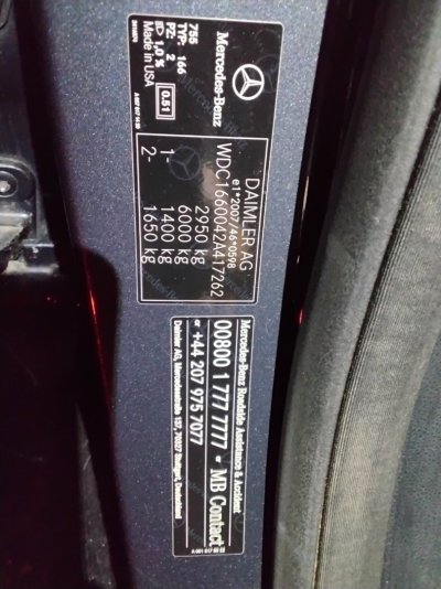

I suspect that you may have an AMG or Sport trim. If so then most tow bar fitters and manufacturers will immediately say “no” because AMG models are not homologated to tow, which is true in the vast majority of cases, except for AMG SUVs.
As long as your car is homologated for towing, then you can legally fit and use a towbar.
Some cutting of the bumper may be required if there’s not a removable panel. Find a decent fitter and show them a photo of your VIN plate which will confirm whether it is homologated. Post a photo of it here if you’re not sure how to read it.

Paul, can you post a photo of your VIN plate or type the numbers on the VIN plate? This will confirm whether the car is type approved for towing.

If you show that photo to a fitter then that will help. As was the case when I had towbars fitted to my W166 and W164, you’ll probably need to accept the risk that it may not risk, as the fitter and manufacturer will be unwilling to do so.
