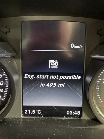

Hello, 1 month ago the check engine light appeared on the dash on my C220D Sport late 2016 and after the diagnosis it came up it was the NOx sensor that needed replacement (P220162- NOx sensor cylinder bank 1 has a malfunction) the warranty company didn’t wanted to accept the garage sensor and they have sent their own part to be replaced, after a day of the repair the check engine it’s again on and this time with another error (P229F09- NOx sensor 2 , cylinder bank 1 is faulty ) and today after a few miles the “Eng start not posible in Xxx miles” appeared as well .
The garage said the part provided by the warranty wasn’t genuine MB and this could be the issue … this can be the issue here ? Nox sensor 2 it’s faulty too and needs to be replaced or this it’s just a problem with the part because it’s not 100% compatible ?
Thank you in advance for your advices

1. And 2 should be changed together. Coded in and new software written in.
They should be done under warranty NOX sensors but there is also a way for them to be coded out and the system will still regen etc. There is a local German car specialist who now provides this service for mercedes as the sensors are on back order still.
Hello is sensor 1 and sensor 2 looks same? And i can change by me self? Or i should go to a workshop?
Go to mb . Or a very well informed independent specialist.
