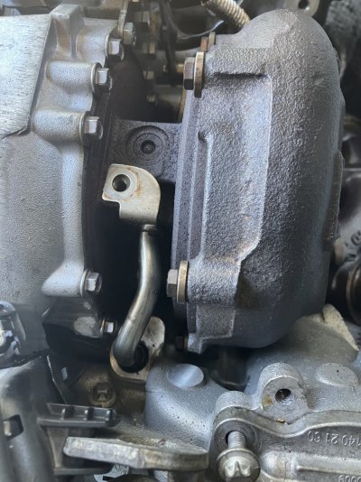

I'm replacing my oil cooler seals and have wrestled all the turbo bolts loose (special shout out to swivel-head ratchets and 'torque amplifier').
The oil feed seems to be a press-fit from the top of the block, contrary to all the videos where it's screwed into the top of the turbo.
Does anyone know how to remove this line? It's now holding the turbo down so I can't get it out...
It’s actually a coolant line. It’s only pressed in with O ring each end. Jiggle the turbo and pull it out. Replace the O rings and lube them a little before refitting
Thanks. I had persuaded it out just a bit after posting.
