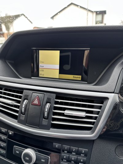

Thanks got it but does anyone know how to get music through BT can’t find it anywhere only got This list below I don’t have a menu list saying audio like other videos I seen , I get to this menu by press cd Hillington cd and click and this comes up but no bt . At a lost will I cable connected to usb in glove work as substitute

From memory (it's more than a decade since I had my 2011 E350CDI), Bluetooth Streaming capability was introduced part way through that model year, so it's possible that your car doesn't support it.
If it has the rectangular Media Interface socket in the glovebox, then you can connect your iPhone to it and have control of the music on it via the car's controls. You will need to buy the appropriate interface cable though.

Music streaming over Bluetooth is available with NTG4.5, but not with the earlier NTG4. 2011 was a switchover year between the two.
Check the Datacard using an online VIN decoder, and look in the 5xx section for your infotainment system. The code will tell you if it's NTG4.5 or the older NTG4.
I think you have to run it through the aux cable in the glove box if my memory serves. I think you can use a usb stick if you transfer music from your phone onto it. Apple and Comand aren’t very good bedfellows, my text feature just disappeared after one update and is yet to return
