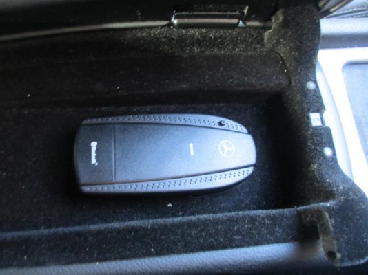

You will need phone prep (you should see a connector in the centre armrest if you have this, and a bluetooth puck.
what you are seeing is Bluetooth for a headset only.

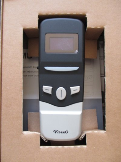

As above, you need a bluetooth adapter. A 2005 car should have an UHI kit, the 6310i cradle should be detachable and you can replace it with a bluetooth adapter (use the HF profile adapter as iPhone does not support SAP, the other adapter type).
If the 6310i was seated on a cradle with a curly cable, you would need a ViseeO bluetooth adapter that replaces the 6310i phone.
You would then pair your phone with the bluetooth adapter, not the head unit.

The first iPhone appeared about 2 years after your car was built ,my 2006 C class has a UHI plugged into the 'hot shoe' in the armrest , my car is telephony ready and connects with my iPhone 13 despite just having Audio 20, but the whole experience is dated and pretty grim .
The keypad on the dash will not work so scrolling on the dash is the only way to make a call which then only comes out of one speaker (passenger footwell) . Personally this doesn't bother me as I am quite happy not to speak to anyone while I am driving.
If you really need a proper working phone there are many options out there. Buying an expensive MB UHI (be aware , they all look the same but are not) is not one of them in my opinion.

It's not complicated.
Get one, plug it in, pair the phone and it will work faultlessly.
It did on my old CLK.
