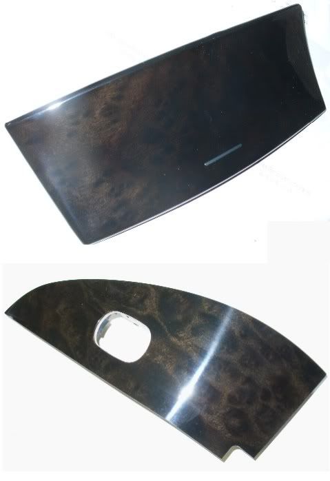

Can someone with access to the EPC system do me a part number check please, seems i've managed to come up with 2 different part numbers for the same thing :rolleyes: :doh: and as there are other related/linked parts i don't want to accidentally get a mixed set.
A203 680 84 39 9C91
and
A203 680 5182
Sorry, no colour code digits for the second one :(
If it's supposed to be the front ashtray cover in Anthrecite, the first number is correct.
If it's Birds Eye Maple then the 2nd p/n is the one.
Best to check using the VIN.
ah crap, they are different colours ???
it is a front ashtray cover for a W203, the first number was tagged as birds eye maple anthracite, the second just birds eye maple.
so what's the difference ?
I have the corresponding numbers for the other parts to go with the 2nd number, but not the first.

CODE 9C91 is sometimes referred to as CINNAMMORA ANTHRACITE
yeah, seems so, hard to tell without seeing them all side by side, these are Cinnammora Anthracite as far as i can tell. (although the seller has the ashtray cover listed as birds eye maple)
also, hard to tell which i prefer !!
can you dig out the matching numbers easily for the other parts in the Cinnammora Anthracite ?
these are the ones i have for B.E.M. so far, although that window switch cover is for a LHD car i think, it would be interesting if the RHD part numbers were available (for 203 coupe) i've tried via the russian parts sites, but not always easy to follow or get it right !

the other one i like is the olive ash burl, that's a nice colour without being too garish an appearance, although the darker ones do look better i think
ah, might have found them, just not sure if they are for pre-facelift or not !!
