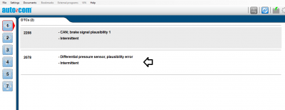

Hi guys, new to the site and owning a sprinter too. Today travelling back from work MIL light came on, lost pull (not limp mode though). Got home and scanned it and came up with the 2078 (P1402) code, differential pressure sensor, plausibility error. I've got a new sensor on route but I had good going over where I'd expect to find it and I came up with nothing. Can anyone assist me on this please I'm really not familiar with these vehicles and I called it a day due to daylight I thought id seek some direction.
Its a 57 plate 2.1 CDI, 311 sprinter (906) eng code: 646.985 DPS code sprinter.png
