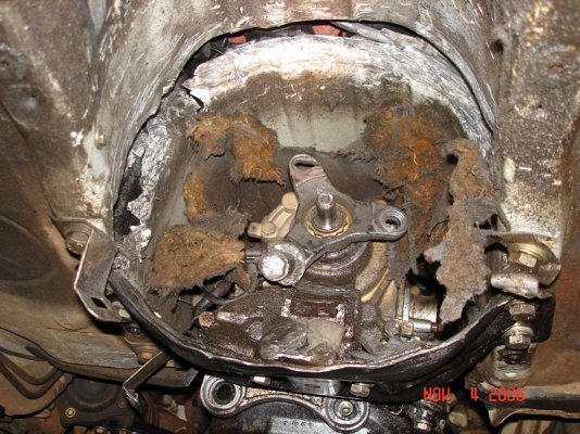

Gavnr Do get it done asap ,and take it easy till its done .This is what you get if its not replaced .
Thanks, will certainly check out properly with an indie.

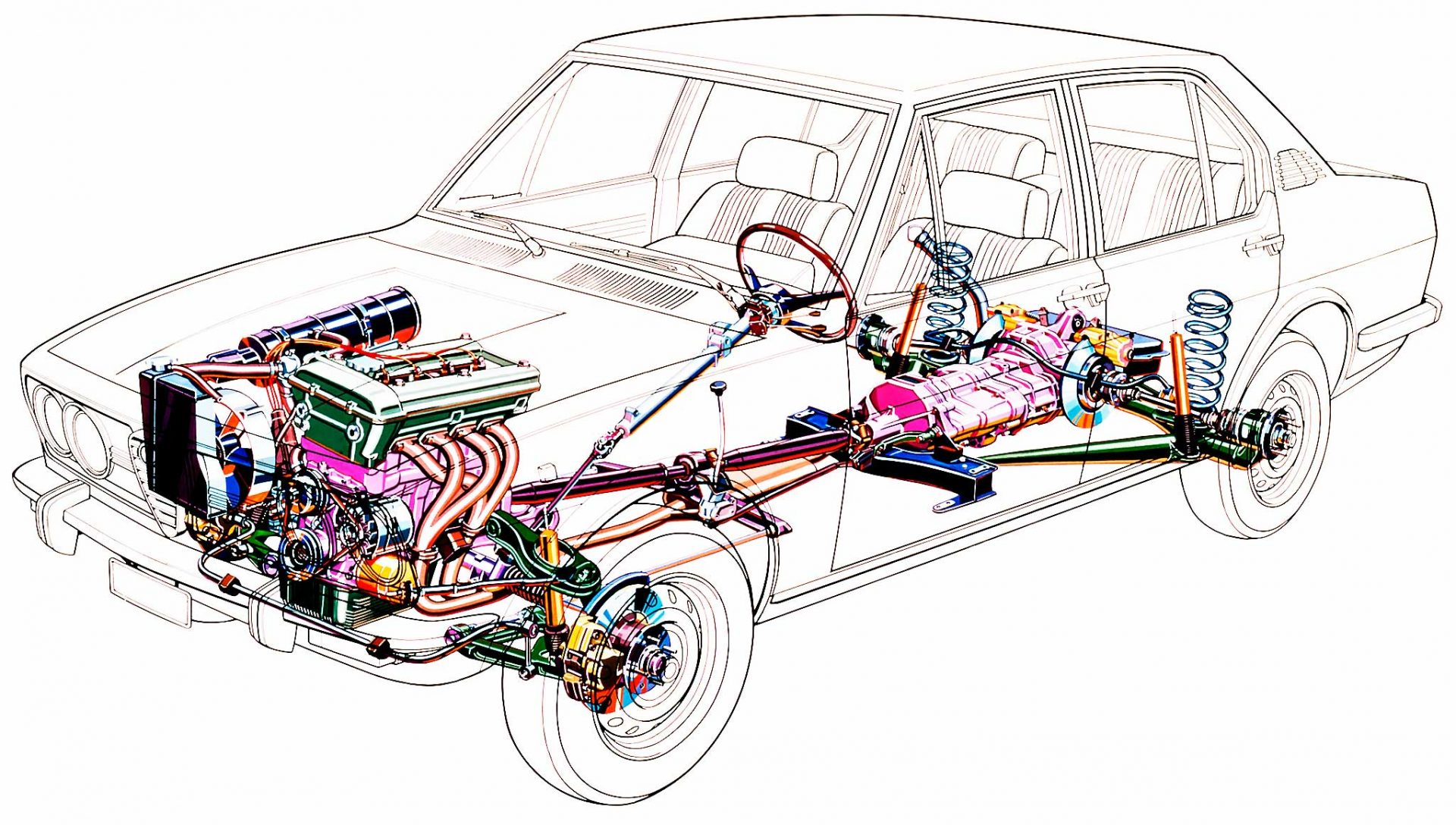

The only car I've ever replaced prop shaft dounuts on was a 1979 Alfetta, but on these cars the engine is at the front and the gearbox is at the rear, meaning that when you redline it (as you do with Alfa) the prop rotates at 7k rpm... which is why the dounuts work hard.
This explains it well... :D
