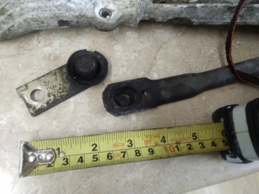

R129 failed wiper ball joint.
RichardF
Aug 24, 2013
694
Sl 320
Anyone had any joy having this replaced or is it a whole new (used) assembly req.
CHECK FITMENT!!!!
Interesting thanks, not quite sure they'd do it though.
I take it the ball joint is between the rotating short motor drive arm and the long reciproccating transfer arm to the jumping mechanism?
Yes that's the fella. I've had a quick response from that ebay site, apparently the Audi A6 ones fit so ordered a kit.
They come in a set of 4 so if they work and anyone wants one they're welcome to it.
New nylon sockets arrived, not reassembled yet but looks like it'll do the job. It feels a little tight so I'm going to bed it in with some cutting paste, disassemble, clean, and lube.
