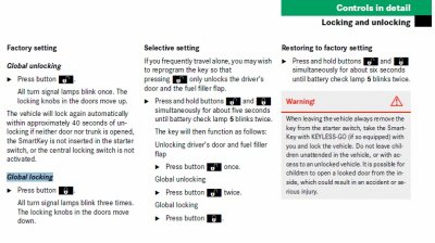

What you describe above is programming the remote to go from Selective Unlocking to Global Unlocking;
Selective unlocking… only the driver’s door and fuel flap unlock.
Global Unlocking… all doors, boot/tailgate and fuel flap unlock.
