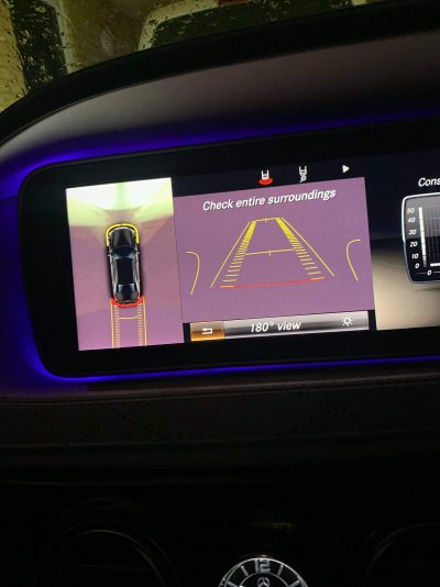

Hello everyone i have problem with my rear camera on my S500 year 2014. Suddenly stops working without any messages coming into the dashboard, the strange is all the parking sensors and etc are working fine, front camera also works fine, any other 360 positions working fine. And the last strange thing is the rear camera starts working normally and after 1-2 seconds stops. Any suggestions??

Tricky one.
My initial thought is to involve someone else and have them check the rear camera is mechanically "poking out" quickly and is not struggling (grating / scraping etc.).
Mine is instant so it must poke out quickly.
They do this to keep the camera clean which is nice as my previous C216 CL500 used to get a grubby camera daily in the colder months but it's obviously possible for it to malfunction.
Hello, thank you for the reply. There is a option to open the camera from the dashboard there is no problem with poking out normally, now i will try to clean around and see if there is some difference. I already spoke with someone and he told me this is weak point of MB. If I can't fix it probably i will take it to MB for Star diagnostic
