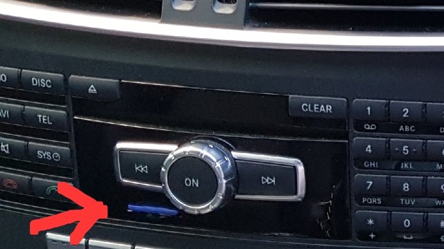

Your car will have either COMAND NTG4 or COMAND Online NTG4.5.
If the main unit has a large PCMCIA slot under the on/off volume knob, right in the middle, then it's NTG4.
If the main units has a small SD-Card slot under the on/off volume knob, but not right in the middle, but slightly to the left, then it's NTG4.5.

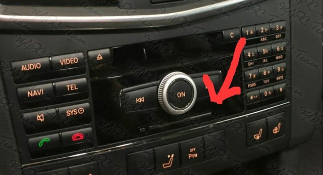

COMAND NTG4 with the (large) PCMCIA slot in the centre:
