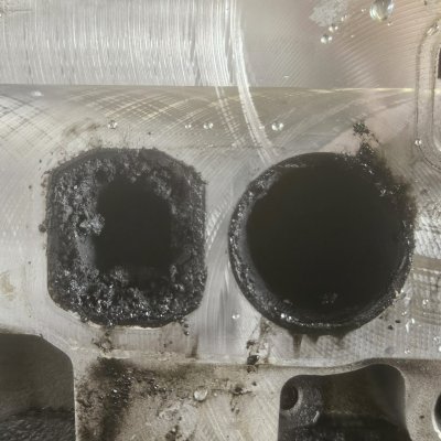

All work is done now and the car drives perfect, all intakes were cleaned,
That is how they looked, all were cleaned along with the inlet manifolds, throttle body, EGR flap and EGR valve, all seals replaced and a full service at the same time.
