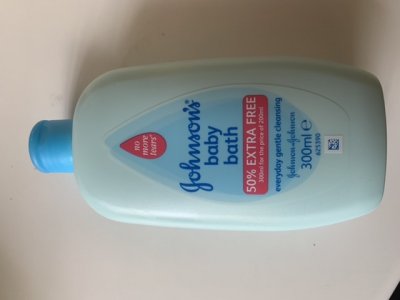

I should have mentioned, I intend on using Johnson’s baby shampoo (blue bottle). Quite a few people have recommended it.
Thought the baby shampoo was the clear bottle/yellow in colour.....Not that it would make any difference 🤣
