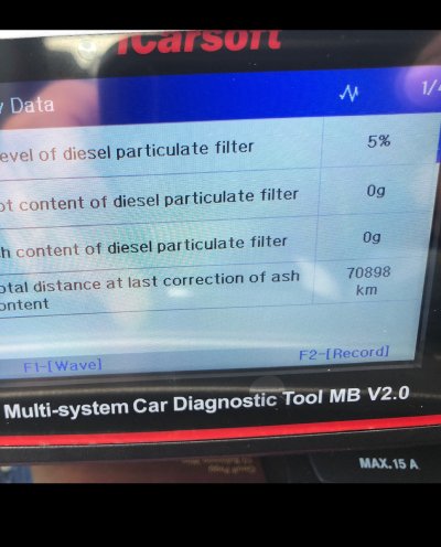

I have the Icarsoft MB V2 and did monitor my regen once when I took it for a 20 mile drive, if I hadn't had it plugged in during the short journey I would never have known the regen had taken place, there was no indication at all, I didn't go above 60mph, no sport mode or high revs, it happened completely passively. The fill level went down to 5% then stopped.
But unless I'm mistake the Icarsoft MB V2 will not do a forced regen.

is it able to tell the car it has a new dpf filter fitted?
Very much doubt it , it can show soot / ash levels , when the last time the regen took place , time / mileage / fuel used since last regen etc.
