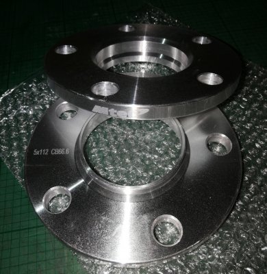

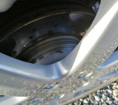

<div class="bbWrapper"><a href="https://forums.mbclub.co.uk/attachments/img_20181114_200903-jpg.81273/" target="_blank"><img src="https://forums.mbclub.co.uk/data/attachments/54/54872-ff0f21b4b9a516b1e5321a3193512ad6.jpg?hash=_w8htLmlFr" class="bbImage " style="" alt="IMG_20181114_200903.jpg" title="IMG_20181114_200903.jpg" width="400" height="357" loading="lazy" /></a> <a href="https://forums.mbclub.co.uk/attachments/img_20181114_200840-jpg.81272/" target="_blank"><img src="https://forums.mbclub.co.uk/data/attachments/54/54871-c5433ba734f4fba4c01f8c5d801928f2.jpg?hash=xUM7pzT0-6" class="bbImage " style="" alt="IMG_20181114_200840.jpg" title="IMG_20181114_200840.jpg" width="390" height="400" loading="lazy" /></a> <a href="https://forums.mbclub.co.uk/attachments/img_20181114_200927-jpg.81274/" target="_blank"><img src="https://forums.mbclub.co.uk/data/attachments/54/54873-d371162b89c6a90b76a2ae021174bf94.jpg?hash=03EWK4nGqQ" class="bbImage " style="" alt="IMG_20181114_200927.jpg" title="IMG_20181114_200927.jpg" width="276" height="400" loading="lazy" /></a> <a href="https://forums.mbclub.co.uk/attachments/img_20181114_200947-jpg.81275/" target="_blank"><img src="https://forums.mbclub.co.uk/data/attachments/54/54874-4d1d4b23465531dc6771f68a38a5055a.jpg?hash=TR1LI0ZVMd" class="bbImage " style="" alt="IMG_20181114_200947.jpg" title="IMG_20181114_200947.jpg" width="236" height="400" loading="lazy" /></a> <a href="https://forums.mbclub.co.uk/attachments/img_20181114_201003-jpg.81276/" target="_blank"><img src="https://forums.mbclub.co.uk/data/attachments/54/54875-fbb8d0efcbe6da182b3e1a79d12ee6fc.jpg?hash=-7jQ78vm2h" class="bbImage " style="" alt="IMG_20181114_201003.jpg" title="IMG_20181114_201003.jpg" width="254" height="400" loading="lazy" /></a> <blockquote data-attributes="member: 139254" data-quote="HarmeshK" data-source="post: 2682179" class="bbCodeBlock bbCodeBlock--expandable bbCodeBlock--quote js-expandWatch"> <div class="bbCodeBlock-title"> <a href="/goto/post?id=2682179" class="bbCodeBlock-sourceJump" rel="nofollow" data-xf-click="attribution" data-content-selector="#post-2682179">HarmeshK said:</a> </div> <div class="bbCodeBlock-content"> <div class="bbCodeBlock-expandContent js-expandContent "> I should add that I’m only doing this for aesthetic purposes!<br /> <br /> But obviously I don’t want to effect the way the car drives at all.<br /> <br /> Does anyone know if running a larger spacer on the front axle than the rear axle is a bad idea? </div> <div class="bbCodeBlock-expandLink js-expandLink"><a role="button" tabindex="0">Click to expand...</a></div> </div> </blockquote>I would say not.<br /> Im running spacers for aesthetics aswell.<br /> Some will argue that it puts more pressure on the bearings but we're not talking much (unless you're Carlos that is <img src="https://cdn.jsdelivr.net/joypixels/assets/8.0/png/unicode/64/1f609.png" class="smilie smilie--emoji" loading="lazy" width="64" height="64" alt=";)" title="Wink ;)" data-smilie="2"data-shortname=";)" />)</div>
