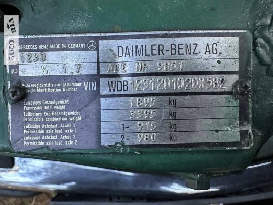

So after a bit of google searching, I've found a 1980 W123 that had the GTW printed, so Mercedes had been doing it for a while.
On the other hand if you imported an Australian W124 by @ALFAitalia logic you'd be breaking the law just by the car existing, as they didn't print any weights on the VIN plate at all so you'd always be over the maximum permitted vehicle weight of zero and also according to his logic Mercedes must have had a reason why they said no to the vehicle having any weight whatsoever so probably best not drive it at all...
So it does seem to depend on what market the vehicle was going into as to what weights were stamped on the VIN plate. So I guess the question is, does anyone have a UK market W124 with the Gross Train Weight stamped on the VIN plate.
