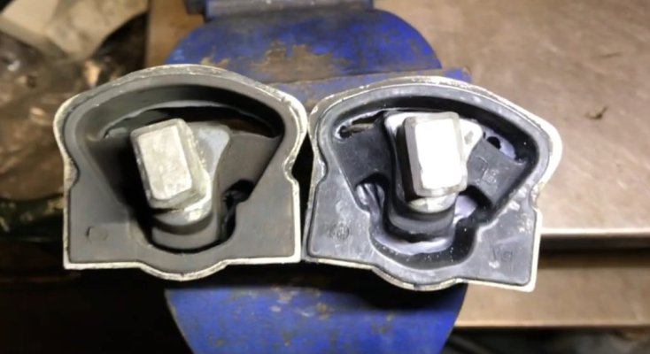

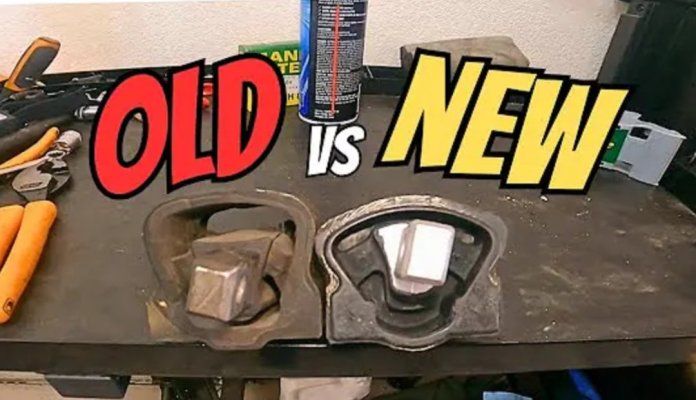

Facelift S204 C250 CDI Auto , small noise / grumble / vibration upon acceleration most noticeable after a roundabout to dual carriageway ever since I've had the car .
Now given how cheap and easy it is to replace it would be rude not to .
It's a common design and shape that's used across a number of models for some time now but it's not exactly robust so a common / a given issue .
Quite an extreme version of wear
More usual
So my question is there any uprated versions that would fit from anyone / AMG ?

The old one in the lower photo does not appear to have any tears or cracks in....the usual clue of failure in.....just a bit squashed....I bet the new one will look like that quite soon! The one in the top pic however....that's proper cream crackered!!!
