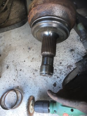

Update.
4.5 hours with a break. The old reluctant ring was in two pieces so it’s no wonder it wasn’t happy. No issues except reinstalling the linkages was a bit of a ball ache as my iCarsoft software couldn’t depressurise the rear suspension air bags. Otherwise all easy enough.
Update.
An attempt at photo posting
cleaned up in 4 minutes with a wire brush on a drill
