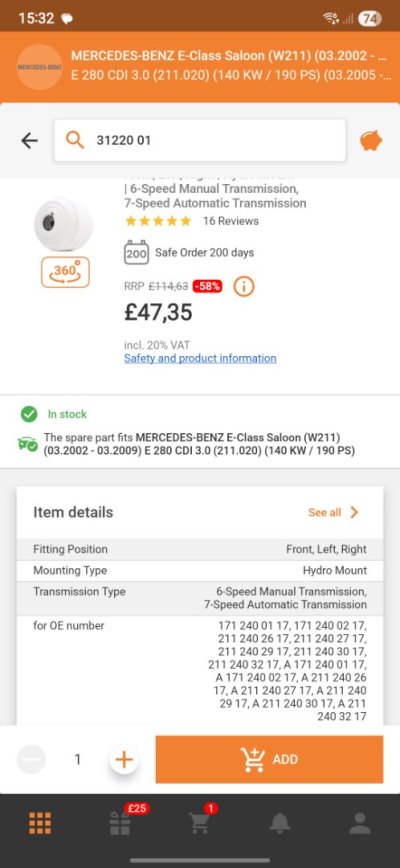

Can anyone advise if this is the correct/sufficient ones to buy, or is there a better make etc, thanks in advance
As long as they are Lemforder . AUTODOC gave me the correct fitment for my 2009 E class (I did a bit of cross checking across other sites to confirm it )
There is no left or right if I remember , it fits both sides .
Hi these are febi ones not lemforder
Ok so just ordered 2 engine mounts from autodoc, downloaded the app and added my car details in, £130 delivered which i thought was a good price, as without the discount they were well over £100+ each, so I wait patiently for delivery, let's hope evri doesn't lose this parcel, 😉 will keep you updated, thanks all for replys and advice
