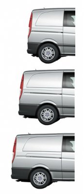

Also. I'm not so sure it's a compact now as there isn't a full side view. I can't see a spare wheel inside in the rear view photo.
I think quite a few people with Compacts just carry a can of sealant rather than having a dirty great wheel inside the van. The difference in length between the Compact and Long isn't great so the Long makes more sense IMHO unless the size is really critical to you. Incidentally Longs are often wrongly advertised as "LWB", which they're not - only the Extra Long has a longer wheelbase. I did this picture a while back to help people tell the difference between the three lengths:
You can't go on not seeing a spare wheel, if it were me I would remove it prior to taking photo's.
