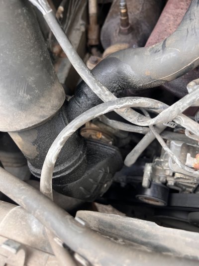

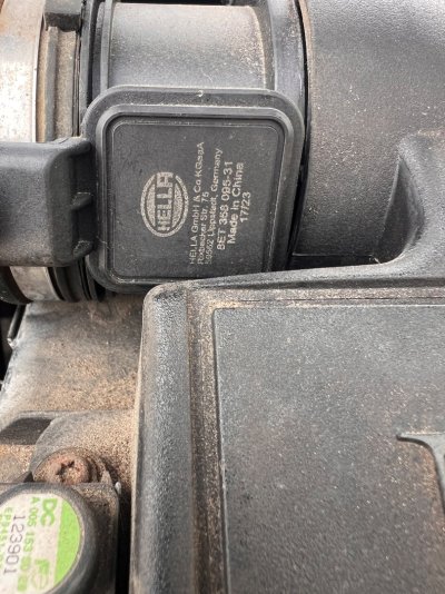

The MAF has been replaced at some point, as it’s dated 2023 and Hella brand. Not sure if this is causing the issue. Also noticed oil residue at the branch on the intake pipe with the crankcase breather.
