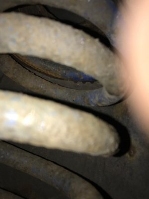

Having now got the car up, it looks like I have H&R FX Springs MB124/1 VA ( E) and as they are silver i think H&R shocks but i cannot see any markings yet.
Also i have 3 pips spring pads, I think i may keep the same set up but change for 4 pip pads for now to get it through the MOT but i will reserach changing the springs.
Renewing the control arm/bushes and spring pads will surely have some difference as there will be no sagging or crushed spring pads?
I think mine is lower than that, so hopefully just worn out components, the bolt holding the ball joint is fighting me at the moment

No its the bolt that goes through the hub and clamps to the top pin of the ball joint looks like its rusted fast, tried heat but that hasnt shifted it, just applied loads more penetrating fluid and having a cuppa!
Success and failure! Well after the mammoth job, which shouldn't have been a big job i swapped out the control arms and replaced, took a day and a half to remove and replace most of the time was spent on removing 1 bolt and doing a few touch ups with some stone chip whilst i had the springs out.
Couldn't have done it with out some air tools/impact gun. How i did it in the end, tapping around the bolt nut and joint with a metal hammer to knock out any rust then soak the hell out of it with penetrating fluid and then but about 10 mins of backwards forwards with the impact gun and ALOT of penetrating oil and we are done.
Failure well as it too far longer and all of the components were fine except the control arms i just put it all back together! ride height has improved about 15mm i guess due to all the sagging bushes and ball joint and no more little knocks and feels good. Well worth the effort and i can always swap out the springs at a later date.
But boy do these get rusty underneath, the suspension mounts are fine just the components and bolts take a hammering my advice would be swap them out as soon as possible, and soak the ball joint bolts for about a week beforehand! then use some copper grease on the bolts for when you have to do it again!
